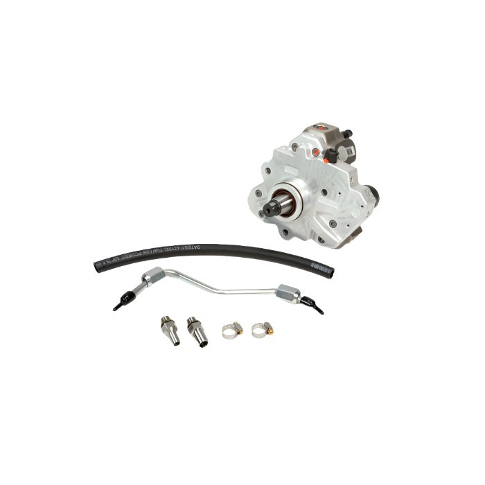

If it were me, and given what you have told us, this would be my choice.
